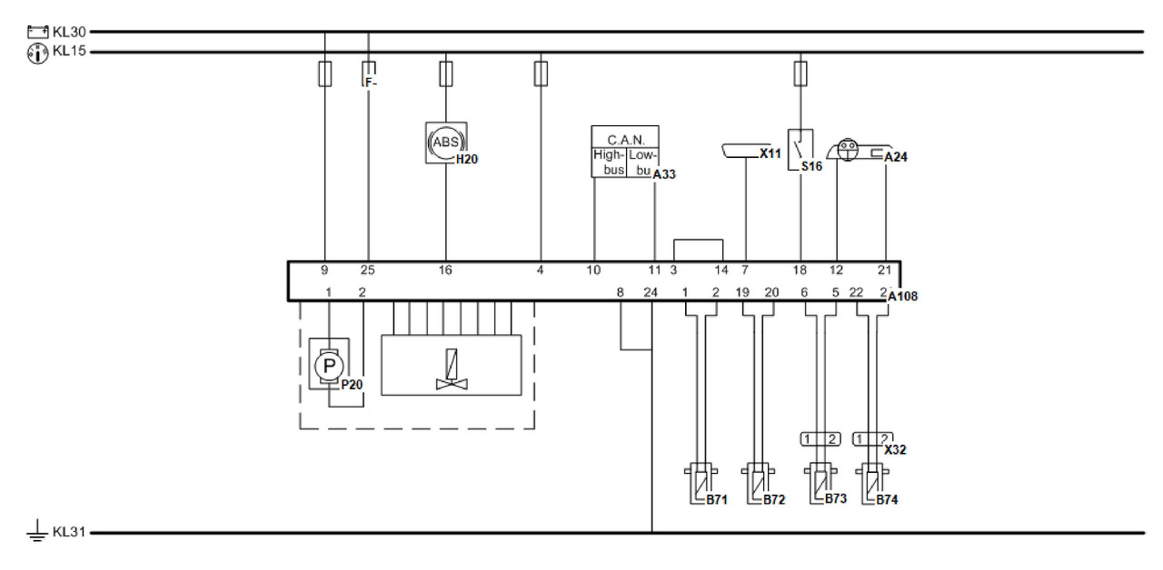

1. Teves 20 IE 25 pin
A108 - ABS ECU
A24 - Instrument tabla
A33 - CAN BUS
B71 - senzor P.L.
B72 - senzor P.D.
B73 - senzor Z.L
B74 - senzor Z.D
F - osigurač
H20 - ABS lampica
P20 - ABS hidro pumpa
S16 - prekidač kočnice
X11 - dijagnostika
X32 - konektor

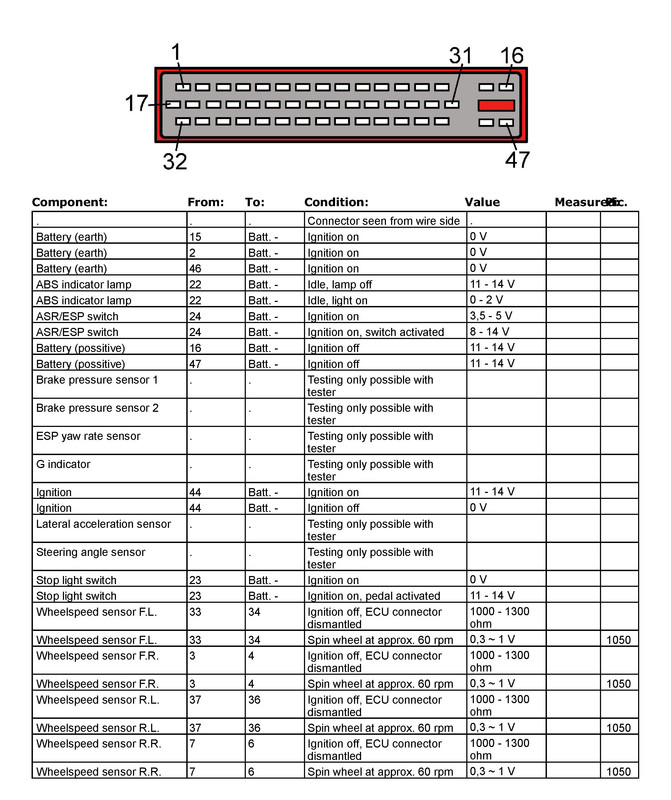

4. Teves 20 IE ESP 47 pin - 5.1999
A106 ABS ECU
A24 Instrument cluster
A64 CAN bus wires
B105 Steering angle sensor
B106 ESP yaw rate sensor
B107 Brake pressure sensor 1
B108 Brake pressure sensor 2
B109 Lateral acceleration sensor
B71 Wheelspeed sensor F.L.
B72 Wheelspeed sensor F.R.
B73 Wheelspeed sensor R.L.
B74 Wheelspeed sensor R.R.
H12 Lights
H20 ABS indicator lamp
H25 ESP indicator lamp
K93 Stop light suppression relay
S16 Stop light switch
S54 ASR/ESP switch
X14 Ground connection
X200 CAN BUS Collection
X32 Collector plug
X41 Diagnostic connector
Y65 Hydraulic unit
Y97 Active Brake booster
  • Poruke: 2128
Odg: Golf MK4 ABS sistemi sa šemama1
« Odgovor #4 poslato: Decembar 12, 2018, 02:23:57 posle podne »

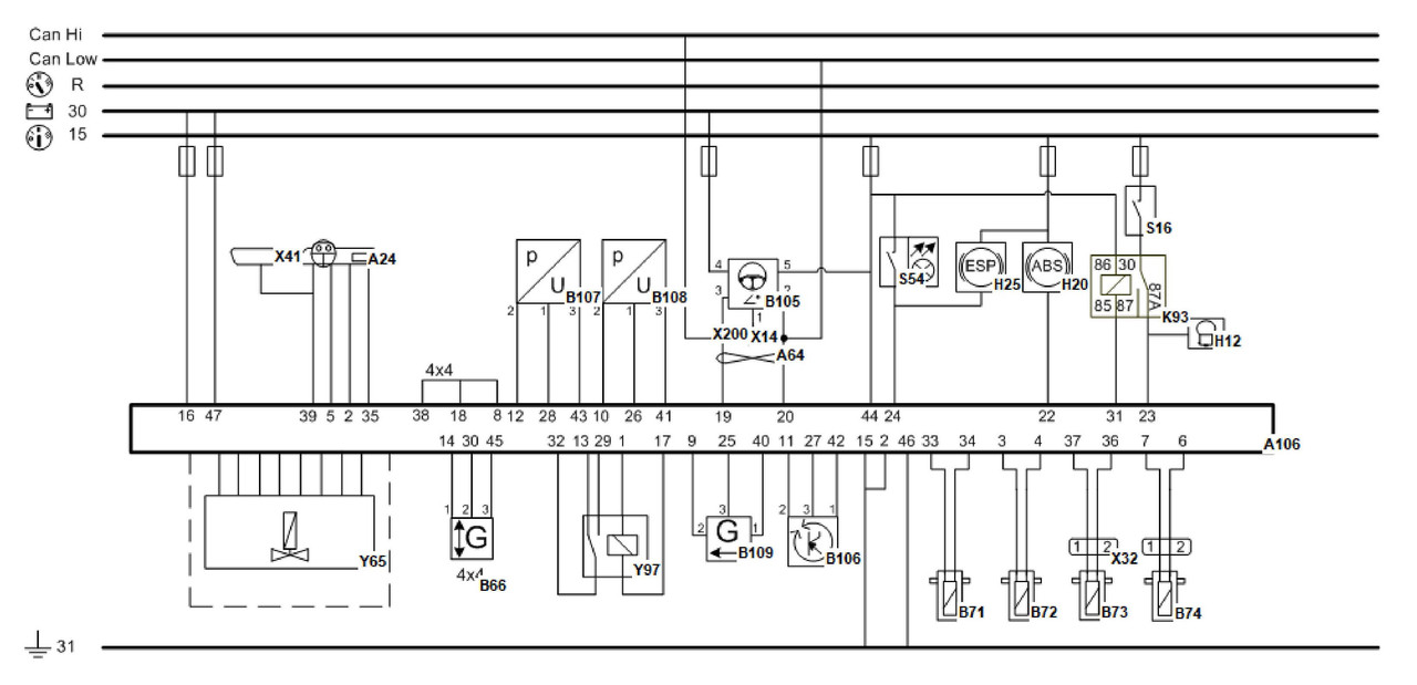

5. Teves 20 IE ESP 47 pin - 8.2000
A106 ABS ECU
A64 CAN bus wires
B66 G indicator
H12 Lights
S54 ASR/ESP switch
X32 Collector plug
Y65 Hydraulic unit

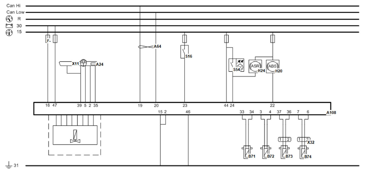

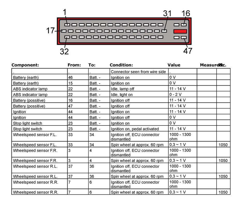

6. Teves 20 IE ASR 47 pin - 8.2000
A108 ABS ECU
A64 CAN bus wires
F- Fuse
H24 ASR indicator lamp
S54 ASR/ESP switch
X11 Diagnostic connector
X32 Collector plug

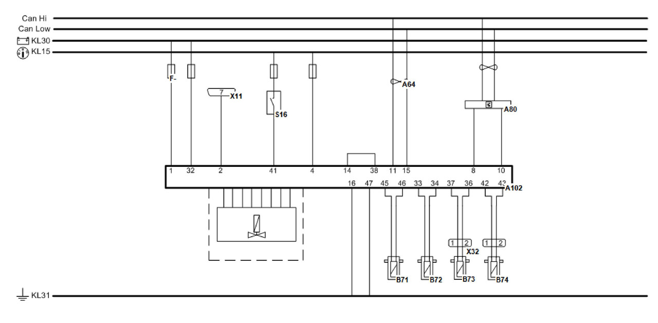

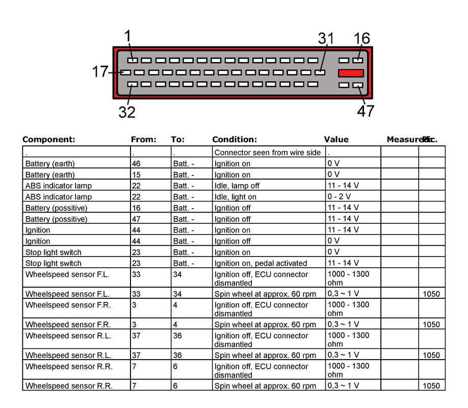

7. Teves 60
A102 ABS ECU
A64 CAN bus wires
A80 Instrument cluster control module
F- Fuse
X32 Collector plug

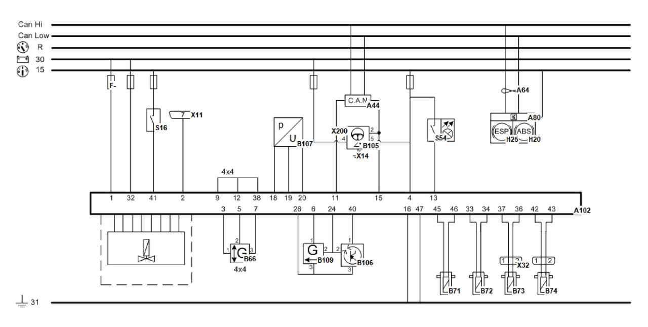

9. Teves 60 ESP
A102 ABS ECU
A44 CAN communication
A64 CAN bus wires
B66 G indicator
F- Fuse
S54 ASR/ESP switch
X32 Collector plug
