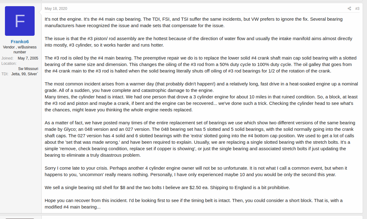

U prevodu, cilindar broj 3 se najviše greje i u treći leteći ulje dolazi iz galerije na bloku odozgo koja se nalazi na 4. ležećem i prolazi kroz 4.
4. ležeći je dole pun, gore uzduž prorezan i ulje kroz njega i dalje kroz radilicu ka 3. letećem prolazi samo kada je rupa na radilici u gornjoj polovini 180°.
Zbog toga na 3. leteći ulje dolazi u intervalima po 1/2. Kada se umesto donjeg punog ležećeg stavi  uzduž prorezan kao i gornji ležeći, ulje će stizati do 3. letećeg 1/1.

"Just replaced the conrods bearing shells and bolts with OEM replacement parts last weekend. The engine is BXE from late 2007, with just 106.000 km done.
As you can see in the picture, the upper halves of the shell bearings are toasted, there is hardly any trace of anti-friction material remaining on them, as opposed to the lower shell bearings, which look almost new. The engine was always serviced regularly, within the first 75.000 km the service was done at the Skoda dealership, every 15.000 km, always with Castrol Edge/SLX 5w30 507.00, and after that I've done it myself every 10.000 km with the same oil.
The crankshaft didn't seem to be damaged, so I just put on the new bearing shells and new conrod bolts. Did the job at a friend's garrage, it took the two of us about 2 hours to complete. So far I managed to drlve it only for about 300 km, and everything seems ok, but for the next oil change I think I'll go with Motul.
The cost of the bearing shells is about 50 euros for the upper halves, 50 euros for the lower halves and 40 euros for the conrod bolts."
Izvor: https://www.myturbodiesel.com/threads/vw-golf-1-9-tdi-2007-major-engine-failure-only-58-000-miles-bxe-engine-code.18744/post-126502
Odg: Stop engine, oil pressure. Passat B6
« Odgovor #75 poslato: Mart 04, 2023, 07:23:29 posle podne »
"A grand on a new engine.... you would be lucky to get a decent used one for that and an exchange bottom end from VW is £2768 alone. Anyway, yes I would strongly recomedn the bearings were changed,I prefer to use Mahle if available but the KS 775 546 00 are the correct "sputter" type as well. The bolts must be genuine 045 105 425 at £6.47 each. It would be interesting to see a picture of them when they are done and see if the upper ones are worn like this which is fairly typical"
